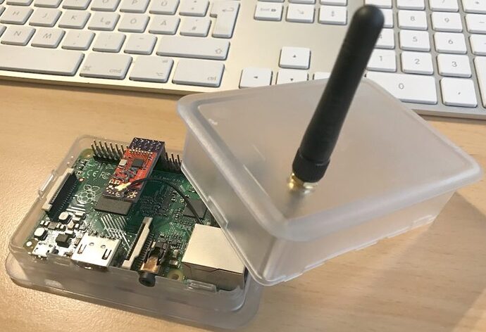

Well, may be. Although the WORKING message come through reliably and also messages sent from homegear don’t get lost. What kind of antenna do you use? Maybe there is my problem. Have a look https://home.hottis.de/wolutator/files/IMG_0536.JPG, can you comment this antenna arrangement and give hint?
3a is -58, that’s a fair reception. I have sensors with worse RSSI which work without any problem.
I’m using a +2dBi 868MHz Antenna on my self developed SPI board.
(CC1101 SPI Adapter mit u.FL Antennenbuchse – allgeek techblog)
Not sure if the second radio in your installation interferes… could you maybe dactivate or remove the second one?
Many people had success by using a 8,6cm wire antenna which they have in a small tube so that it does not bend.
All in all I’m not a fan of these generic curled antennas as you use them, see https://www.youtube.com/watch?v=ZpKoLvqOWyc
Thank you for these hints. I changed my antenna setup and at the moment I receive all the STATE messages from the homematic devices.
