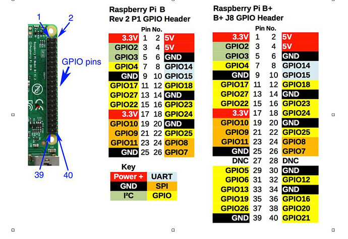

well, I know these modules… I’ve built them :wink:
You are off by one Pin. Pin 1 of the Pi is where the SD-Card comes in.
See where the small notch is on the left of this picture? There’s Pin 1.
Or see here:
Cheers,
Patrik
