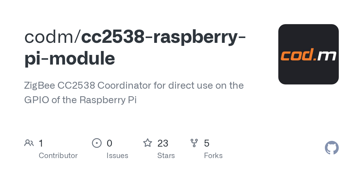

thank you very much for your answer, I have already noticed that in the meantime. Unfortunately I had already bought this stick when I realized that it is not supported by homegear. So at the moment I’m using ZigBee2MQTT to use this stick for the first time.
My plan is to build my own interfaces based on TI CC2538. (Electronic engineering was part of my studies and is still one of my hobbies)
